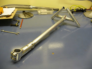

Therefore Mr K set up said lathe and promptly made some possum bars and a 64-tooth chainwheel.
The bars were to be welded up by Gavin Keats who is an aircraft engineer and who has built his own aluminium velomobile. This resulted in:

1) Gavin Keats is going to weld up the bits for the tiller next Wednesday, that means I can install it very soon and see how bad the handling is, if bad I will ditch it and return to the original bars. In programming terms this is known as a ternary statement and in this case would be written like this:

Possum[1] bars are *quite* hard to get used to at first. I rode on the lawn at first and crashed a lot, then began to get the hang of it a little, so this morning I took the Ratracer over the ghastly Ashley bridge and up to Carrs road which more or less goes straight for 19km right into the wop wops. It does wiggle a little and also goes up and down rather a lot as roads do, but because it goes nowhere it is very quiet. Anyway because I was new to the bars and occupying more of the lane than I really should I was taking it relatively easy at first. I averaged 38.2 kph for the 40km with a max of 62kph ( that's ~23.8mph and 38.7mph resp. in old money). The bars are decidedly twitchy and I'm having to learn to ride all over again it seems; however by the end I was able to pedal reasonably hard around gentle bends, but tighter bends had my sphincter all puckered up in an unseemly manner. This will probably ease. The 64T chainring was a great success and I was able to use top gear for extended periods over 50kph with no trouble as long as the road was straightish. I also seem to have a death grip on the bars at the moment; the handling improved when I forced myself to relax when I became aware of it.
